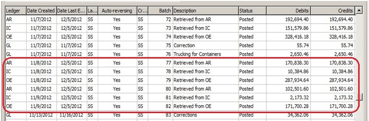

OK, now to figure out how that can happen. The only way I can auto-reverse a retrieved batch is to: i) create a new GL batch, ii) use the Copy function to copy the retrieved transactions from the original batch to this new batch, iii) the new batch can be auto-reversed. However the clue that this has happened is that the new batch shows "Ledger" = "GL" (though the transactions keep "IC"). Can you confirm that the "Ledger" column shows "IC" and not "GL" when looking at the batch list? I know that's an unlikely occurrence but we need to rule it out.
#35278 - 01/29/13 10:32 AM Re: Reversing Issue in GL [Re: Bruce Gardner]
Here is a look at the batch status, what I am not seeing is the batch doing the reversal. As noted the original batches which you can see has the sub ledger Source however,it is saying auto reversed and the description states Retrieved.
Batch Status.jpg (108 downloads)

Bruce Gardner Online   content
Posts: 3678
You won't see a separate batch when "Auto-retrieve" is selected. But if you look at the posting journal, you will see both the original entries and the reversed entries.
Your screen shot leads me to conclude that the reversals aren't a result of user activity (well, they could manually append entries to the retrieved batches but that seems unlikely). At this point we have to look to Support for possible explanations.
