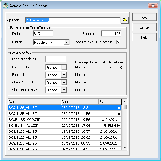

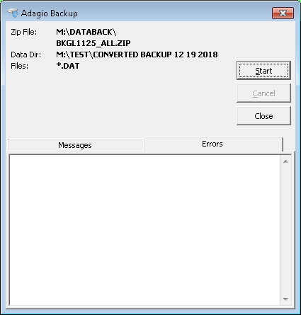

The upgrade was performed on December 19, 2018, and I did several successful manual backups on and before that day. But after the upgrade, the first backup I performed had the replacement error you described. This is the first time that our backups have replaced files. If there's a way to stop replacing files, please let me know. I've attached two more screenshots of our options and complete backup menu.

You should check M:\Databack and perhaps clear out some of the backup files there. Perhaps your backup sequence number has been reset and you are updating existing backups rather than creating new ones. You should also make sure that there is plenty of disk space available on M:\
I would work with your consultant to see whether there is an explanation for the missing lines and/or orders. Have your staff seen any unusual messages while entering orders?
How often do you run the Data Integrity Check? Based on the size of the ZIP files displayed in your Backup Options, I expect that it takes some time to run the DIC. You might want to discuss using DataCare to run DIC overnight and backup your data automatically. Kerry Gullins can install an evaluation copy on your system so you can see how it works.
