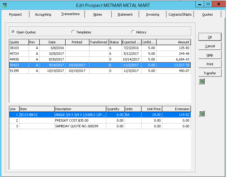

With the version of SalesCQ you indicated, I am unable to duplicate the problem you described, where if a Prospect has multiple quotes, clicking on the record in the Header 'top' grid fails to refresh the associated Details in the 'bottom' grid. For me in sample data, the details always refresh - unlike in the image you included. Also using the cursor key to highlight a different quote refreshes the details for me.

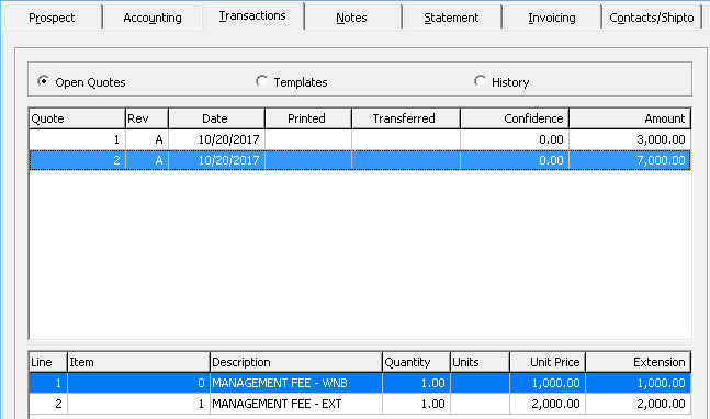

I created new dataset.
I created new prospect and created 2 quotes for this prospect.
Then, I tried to review transactions in view and edit prospect screen. Details were not reflecting data for selected quote #2 (please see attached file). DC has no errors. Providing Samdata in your environment does not have the problem we have, please recommend alternate testing methods in order to pinpoint and fix the problem.
Please suggest the solution on how to "cleanup" DC errors described in previous post.

Victor just replicated this exact scenario on the sample dataset on production server and local workstation environment
Both test are able to show the problem.
