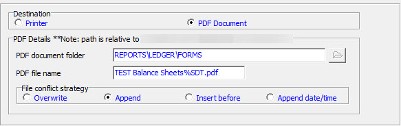

ePrint's options permit this configuration to work with a report set. I tested running two statement groups where both the groups had their print options overridden and set to be appended to the same filename, and it created one file with all the report output as desired. Printboss could also do this.
2015-07-16 9-48-33 AM.jpg (138 downloads)
Description: output configuration

Warren's right. This is pretty straightforward to do with ePrint.
