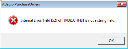

I tried to use F6 to search by vendor and I am getting the attached error.
08-21-2013 12-00-08 PM.png (111 downloads)
#38281 - 08/21/13 12:26 PM Re: Purchase Order Inquiry [Re: Patricia B.]
Posts: 11740
Hi Patricia,
It appears that the smart-finder search on the vendor when using the Find Receipts process is pointing to the wrong dictionary. The @U81CHH8 is the history receipts header smartfinder dictionary, when I suspect it should be looking at the current receipts header smartfinder (@U81CHE8). The reverse is also true where doing a Find on History receipts and a smartfinder search on the vendor field gives a dictionary error, pointing to the Current receipts file.
We'll forward the results to R&D for you.
