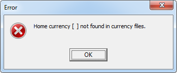

Our company is using SalesAnalysis 9.2A (160608) and the day before yesterday we started experiencing a sign in issue. When logging in to SalesAnalysis, we get a popup error:
"Home Currency [ ] not found in the currency file."
Our other Adagio modules log in just fine and the Currency Code for all other modules are set to [CAD]. Our company's files are located at m:\asp\data.

#55566 - 11/06/17 10:36 AM Re: Home Currency [ ] not found [Re: Organika233]
Posts: 4491
Is your Sales Analysis data in the same data folder as your regular Adagio data?
Can you actually get into Sales Analysis or does the error prevent sales Analysis from opening?
Best guess, the first occurrence of the Home Currency code being read is for Adagio to read Sales Analysis' Company Profile, so my guess is that this file is corrupted.
When was the last time you were able to successfully open Sales Analysis? You could try restoring the back up.
Otherwise this is a difficult problem to resolve in this forum, you might want to reach out to your Adagio Consultant for assistance.
