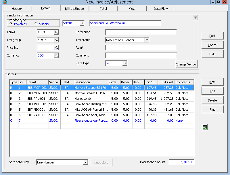

I am trying to create a filter that lists outstanding Receipts only - i.e. the PO was received as a delivery note not as an invoice, and the delivery note has not been subsequently turned into an invoice.
I know there is a setting somewhere, because when I double-click on a receipt, the system knows if it's been invoiced and will tell me so. But I can't find it.

I recall that when I wanted to repair a PO database that had a lot of Outstanding Receipts because they were not posted to invoices ever (the user was posting the invoices directly to AP), the only field that identified the Outstanding receipts info was a detail line Inv Status.
Therefore, you cannot put that on a filter.

I've also discovered that the Inv Status field in the Detail table is more complicated than it appears. Has anyone ever created a GridView that shows Outstanding Receipts only?
