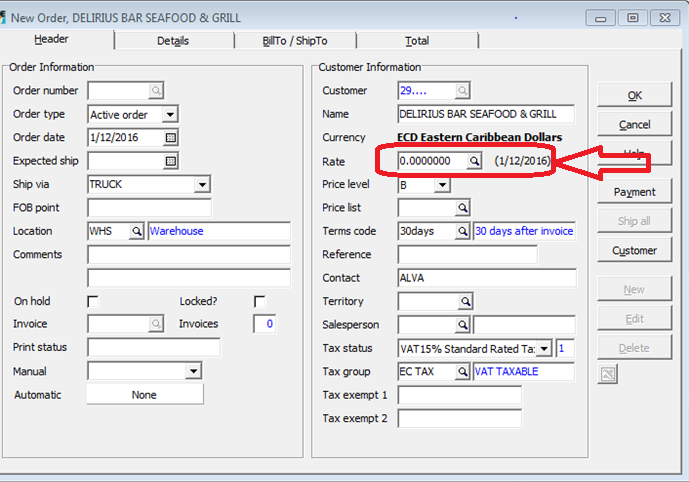

#48533 - 01/13/16 05:05 AM Multicurrency 9.2A Rate goes to zero
Clients just did their upgrades and upon invoicing in OE noticed that after the first couple of invoices that the rate for the customer goes to zero. (See attached)
Can anyone explain this? The client has to keep logging out of the system but only to log back in and do a couple more invoices.
We tried looking at rights issue there was none, check to ensure the upgrades were done correctly, they were. Also tried to delete and re-create the rates. Checked using the SYS admin user and password but it didn't seem to affect SYS user. Could be I wasn't in the system long enough for SYS user to be affected.
Has anyone seen this before. All versions being run is 9.2A
MC Rate Issue.png (138 downloads)

There is no option for that in OE so do you think if I do it in AR it will trickle to OE and solve the problem?
#48580 - 01/14/16 12:56 PM Re: Multicurrency 9.2A Rate goes to zero [Re: GT]
Posts: 4486
Nope, all it will do is correct the Home amount in AR and send the mathematical adjustment to Unrealized Exchange Gain/Loss account. Most likely the sales account will be missing the Home current amount for this invoice.
For OE you could trying doing a credit note and re-invoice to see what happens. You would want the credit note to also have a 0 exchange rate (to match the invoice) and the new invoice to have a proper exchange rate. If this works then do the same thing on the live data. If it doesn't work then your client will either have to live with it or have a database repair (DBR) done. With a DBR you will also need to fix the GL entry with a manual GL adjustment entry.
