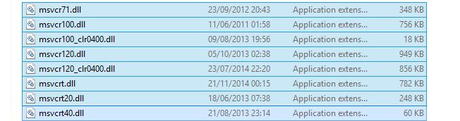

The TraceLog-4-0.dll missing message by itself shouldn't prevent the program from starting or printing from occurring. However, the 'Logon failed .... Vendor code: 160] ...' error will prevent printing. It means that the Crystal program used for printing reports is unable to connect to Adagio ODBC. This could be due to a rights issue or perhaps your workstation is missing a required file(s).
Does the error occur for a single workstation only or for all workstations when they try to print using AP9.2A?
Are you able to print a File | User Preferences, Listing button report? If so, then Crystal is installed properly.
Can you drill down to your c:\Windows\SysWOW64 folder and post a screenshot of all msvcr*.dll files that show in your Windows Explorer window?

I am successful in printing the Listing from User Prefs.
See attached SYSWOW64 screen shot

Here, unzip the attached file to that folder. Then, reopen Payables and try to print an invoice batch listing again.

That missing file did it thank you. The windows 8.1 workstation is now working.
Issue resolved.
