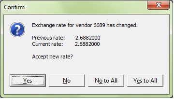

Everytime I go to do a receipt from a PO I get a message about exchange rate. However, it is strange because nothing has changed in the old rate is the same as the current rate.
No file manager here for me to upload picture????
"Exchange rate for vendor has changed.
Previous rate 2.6882000
Current rate 2.6882000
Accept new rate?"
Do I need to adjust something in my Multicurrency. It happens every time I go to do a receipt from a P.O.

#37275 - 06/10/13 09:59 AM Re: POA - Exchange rate message [Re: GT]
Posts: 11732
I have duplicated this issue and it has been forwarded to R&D for a future release.
