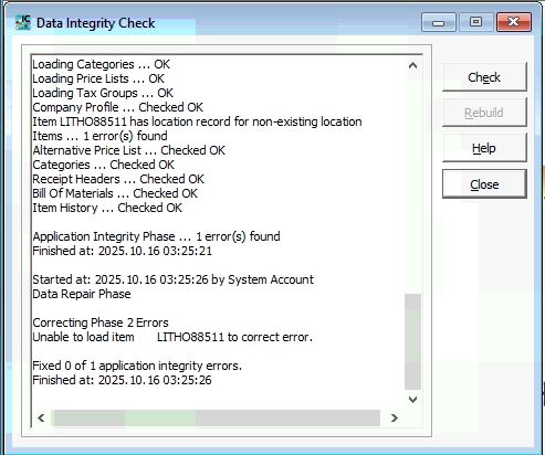

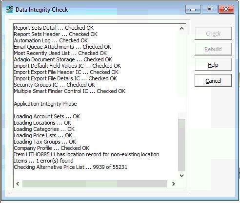

Inventory (DIC) Phase 2 Errors Unable to Load Item "XYZ" to correct error
I am requesting suggestions for a path way to solve my dilemma.
Item "XYZ" has a transaction with LOC = " " blank
Owing to the record having BLANK location I am stuck.
Server drives were failing and error occurred many many moons ago so the restore to last good dataset is no longer an option...
Any ideas welcomed..
I am thinking (GV RW) but ???
Thanks in advance ...

#72052 - 10/24/25 01:48 PM Re: Inventory (DIC) Phase 2 Errors Unable to Load Item [Re: chinmook]
Posts: 4449
GV-RW would be the solution.
