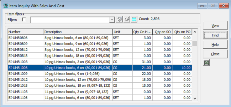

I'm working with a client that's running GL, AP, AR, SA, CQ, OE, IN and DS.
They recently noticed that one inventory item has a figure in the on PO column. We have no PO data and it only shows up on a single inventory item (out of thousands). We're fully up to date on all SPs, clean DIC, I'm assuming this would need to be corrected via Gridview RW, anyone have any ideas as to why this would happen?

Adagio Issue.png (40 downloads)

Just to update people on this puzzle... I found a decade old backup, this item has the 10 PO items. My theory is way back some long time ago there was a PO demo (however no data exists now) and this item was the test subject and never got cleared out. Client is good in knowing confidently there's nothing that they did recently to cause this, and I can't see how this would replicate itself on any other products going forward we're going to mark this as solved.

Jesse: Sounds plausible and I'm buying it! smile
