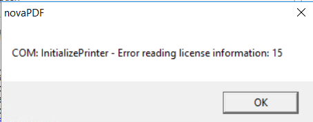

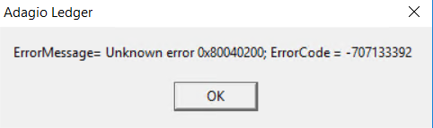

Hello all,
Hope everyone is safe with everything going on currently.
I've had this error in the past, and the typical recommendation from other forum posts and one/all of restarting the NovaPDF service, restarting the system, and or uninstalling/reinstalling the Adagio PDF driver has resolved it. Not this time.
This is a Server 2016 RDP environment and I can't seem to shake the error. Numerous reboots, uninstall/reinstall attempts (some forced as administrator, some not to see if a different result would surface), installed any O/S windows updates, reboots again and still the error lingers. With more and more users moving offsite at the moment EPrint is becoming even more essential. I suspected maybe a user rights issue on the Reports folder, but this is occuring across 12 datasets within a community, within all modules, and started on Monday out of the blue.
Does anyone have any ideas on something else to try?
Thank you.
Image 1.png (148 downloads)
Image 2.png (75 downloads)

Thanks Support, This site is only using Adagio PDF and V2, we haven't rolled out AP 9.3B yet. I did try installing the V3 driver as well to see if that'd change anything for me (and uninstalled, and reinstalled, and uninstalled smile ).
I've tried everything in that thread, ironically except for my own suggestion of setting the service to delayed start. Tried everything else, might give that a go here. I'll update with how I make out.

Nothing I can specifically identify between Friday and Monday, but that caused me to take a look at the last EPrint report and I can't find anything since early last week, the same time some IT challenges were experienced that likely hit on the areas you mentioned. Thanks for the idea. I think this is ransomware related, will still post what I find for others.

Problem was related to corrupted files within the NovaPDF folder.
Uninstall, manual deletion of NovaPDF folders and reinstall of NovaPDF all is EPrinting again!
Thanks Support and Bruce for your input.
