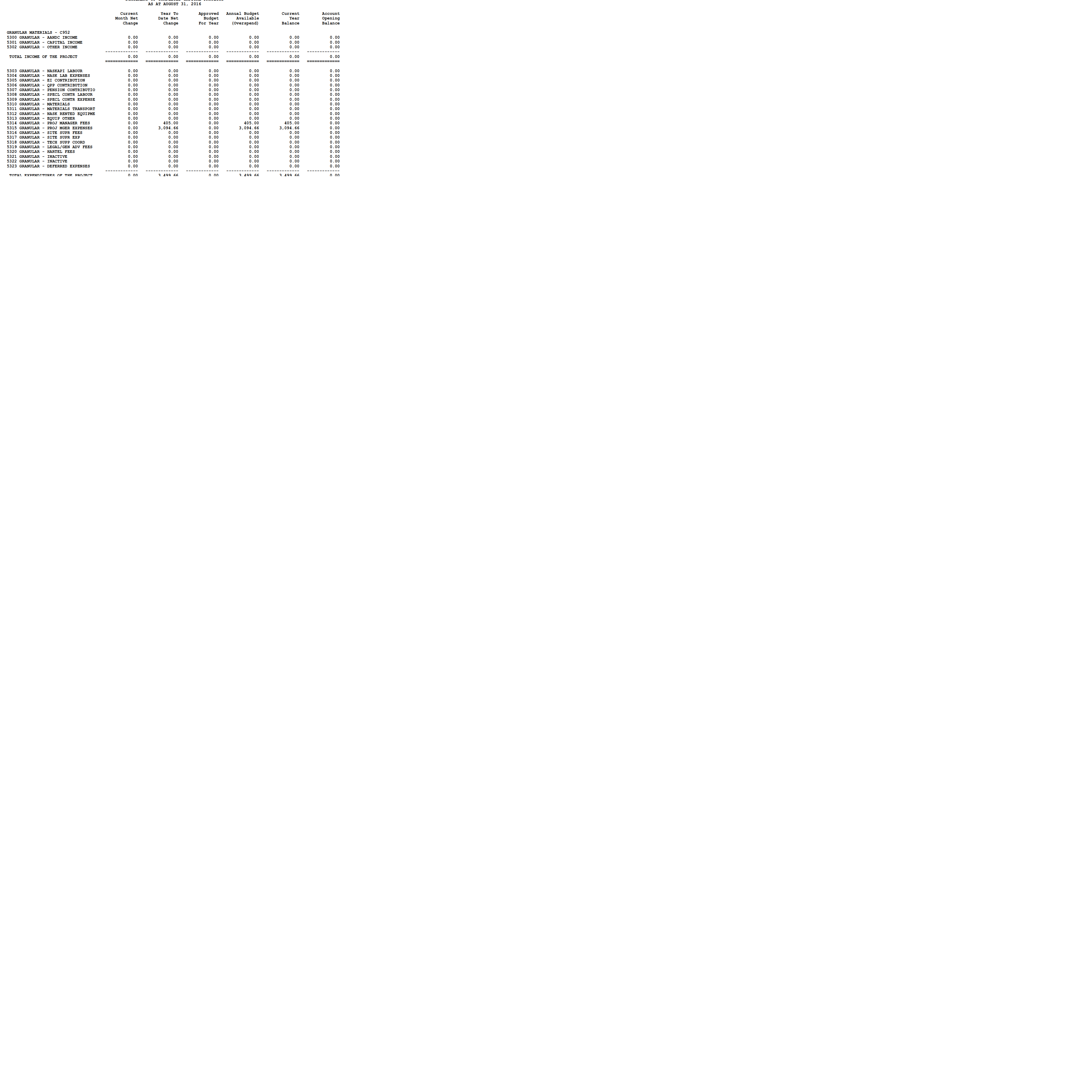

I'm am trying to create a report for my client that will give a breakdown of revenue and expenses vertically. I need a breakdown of a specified range of departments with details to the account level so DEPT>Account detail for each department . The report should be able to automatically pick up any added departments rather than hard code. I'm looking the sample report GL!DepartmentalSummary.Sam and it will do much of what I am looking to do expect without the detail to the account level. I have tried modifying this report as well as building my own to no success. Am I missing something?

here is an example of what i am trying to recreate. They key is the need to be able to pick up new departments as they are added. Thanks again for your help Andrew.
