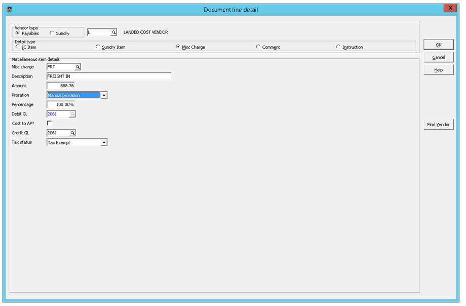

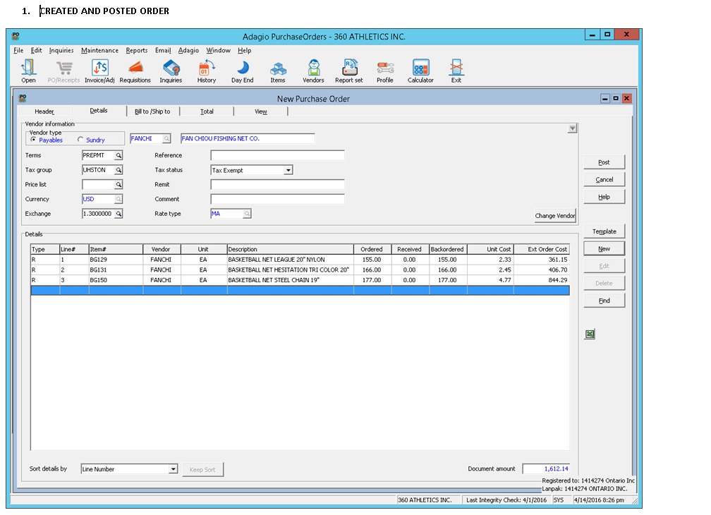

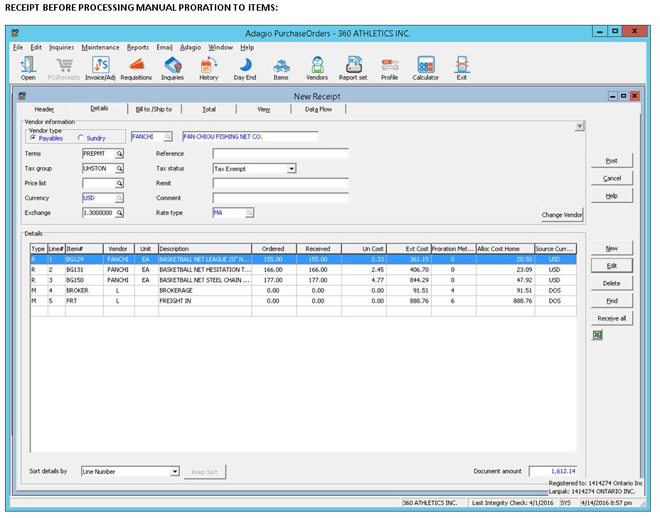

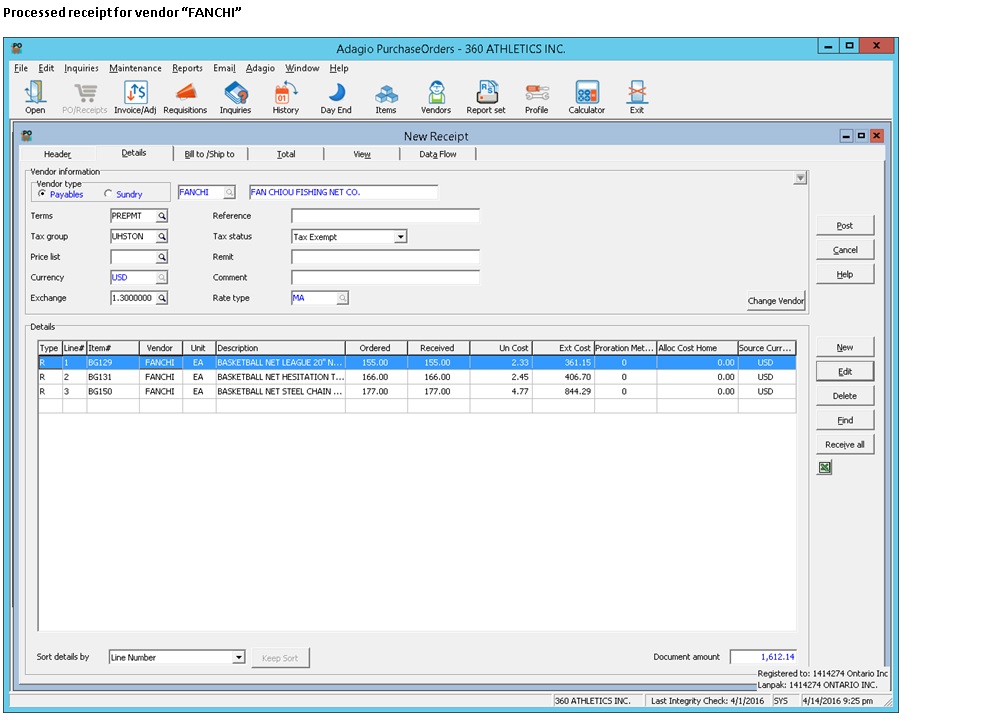

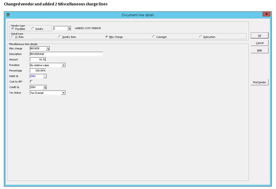

Please see the attached pictures and let me know how you would process manual proration as per below:
Line# Item# Description Manual Proration Amt.
1 BG129 BASKETBALL NET LEAGUE 20" 274.17
2 BG131 BASKETBALL NET TRI COLOR 20" 437.05
3 BG150 BASKETBALL NET STEEL CHAIN 19" 177.54
TOTAL DOS: 888.76
Regards
Victor
PO allocation of misc charges test P1.jpg (271 downloads)
PO allocation of misc charges test P2.jpg (208 downloads)
PO allocation of misc charges test P3.jpg (210 downloads)
PO allocation of misc charges test P4.jpg (349 downloads)
PO allocation of misc charges test P5.jpg (218 downloads)
