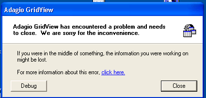

I'm also getting this error for all users when closing the program, although it doesn't seem to do any harm:
Gridview Crash.jpg (80 downloads)
