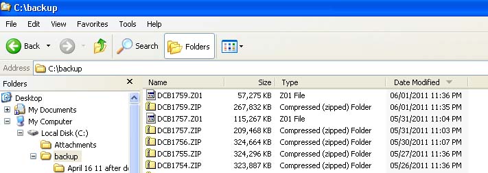

Everything has been working great or so I thought until I needed to restore this morning from a Back Up and I found out that the back up is corrupt. Last night DataCare created a a file called DCB1759.ZIP and a second file called DCB1759.Z01. I cannot open either file. The .ZIP file says it is invalid or corrupt.
It did the same thing the night before and the .ZIP file is also corrupt.
The 3 days before that their is only a .ZIP file and no second .Z01 file and they are all working perfect. I can open the .ZIP files.
Why is DataCare creating a second .Z01 file? And why are my .ZIP files corrupt?

I disabled the scheduled task on the server when I setup the job to run on my workstation. I also re-directed the back up to C:\backup on my workstation.
I've attached a screen shot.
Thankfully I was able to restore from another back up system that ran last night.
Also, there is only one job in DataCare History per day.
back up files.jpg (297 downloads)
Description: Files created by DataCare Backup
Edited by SusanTennier (06/02/11 07:32 AM)
Edit Reason: added note at end

I have always thought the Z01 files were temporary files used in creation of he zip files. One time I had Z01 up to Z14. Anytime I have had the Z01 (temporary files)I have been able to find another server backup or action that was overlapping the Datacare backup.

I can confirm that it only happens at large sites. The Z01 is the temp file and if it still exists then the process of creating the ZIP file was interupted. The problem is what is interupting this backup as it is very random.

If a ZIP file is too large, the resulting files would be named .ZIP then .Z01, Z02 etc. I don't know the threshold size but maybe you hit it in the past few days.

We have duplicated the behaviour you saw (with multiple .Znn files) by having a competing process running on the files when DataCare tried to back them up. Our "competing process" was a large GridView View on a composite table, but any one will do - a ToolKit operation, another backup. You get the idea. Can you let us know what processesyou run overnight in addition to your DataCare Job?
