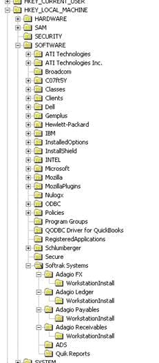

#22621 - 06/08/10 03:47 PM Re: Financial Reporter help not working [Re: Softrak Support]
Posts: 3687
A client has the same problem. Their IT department points out that the workstation in question does not have a key called "Adagio Financial Reporter". Should it simply be added with the "HelpDirectory" key contained therein?
Registry screen.JPG (133 downloads)
#22624 - 06/08/10 04:17 PM Re: Financial Reporter help not working [Re: Bruce Gardner]
Posts: 11739
Hi Bruce,
The workstation setup is what writes the registry entry. If a workstation setup was not done, or done while a different user was logged into the workstation, or done where the user has insufficient rights to write to the registry, then it will be missing.
It could also be that the workstation install should have wrote the entry but did not. Version 9.0B had a problem and to our expectation, this should have been fixed in workstation install by the current version.
If re-running the workstation installation for Adagio Ledger does not add the required entry, then you could add it manually.
#22625 - 06/08/10 04:28 PM Re: Financial Reporter help not working [Re: Softrak Support]
Michael Mulrooney Offline
Registered: 02/07/02
Posts: 839
I believe the entry is in HKEY_CURRENT_USER not HKEY_LOCAL_MACHINE
HKEY_CURRENT_USER\Software\Softrak Systems\Adagio Financial Reporter
I bet it is there if the Financial Reporter was ever opened on that machine.
The HelpDirectory key might be missing or pointing to the wrong folder.
It should point to C:\Softrak\Ledger in a standard install
However, on another of my machines with a full Ledger install it is in
HKEY_LOCAL_MACHINE\SOFTWARE\Softrak Systems\Adagio Financial Reporter
#22626 - 06/08/10 04:38 PM Re: Financial Reporter help not working [Re: Michael Mulrooney]
Posts: 3687
Hi Michael:
On my own computer, I find the "Adagio Financial Reporter" key under both HKLM and HKCU. However, only the HKLM version has the Help setting.
But my computer only has full Adagio installs, never a workstation install, if that makes a difference.
