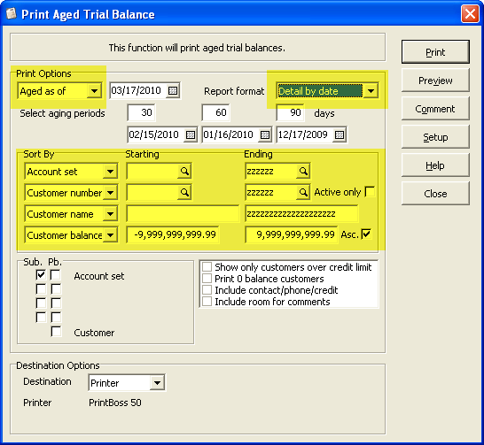

#21401 - 03/17/10 02:24 PM Re: Accounts Receivable Aged Trial Balance printout [Re: Mabel]
Posts: 4505
Please make sure that your setup to print the Aged Trial Balance looks like the picture available from the link below;
Aged Trial Balance.png (609 downloads)
#21413 - 03/18/10 09:05 AM Re: Accounts Receivable Aged Trial Balance printout [Re: Douglas Dickie]
Mabel Offline
Adagio Enthusiast
Registered: 03/16/10
Posts: 24
Tried that, still no luck.
