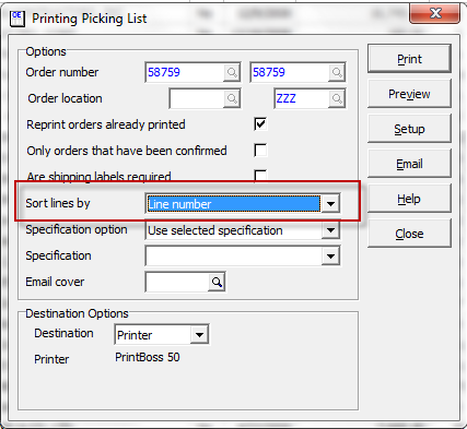

How do I change the order the lines are sorted by in a packing slip (in a detail section)?
Right now it is sorting alpha by part number, and I'd like it to sort by line number descending. I can't seem to find this anywhere on the spec.

After clicking the picking slip button, select "Line Number" from the "Sort lines by" drop down box, as shown in the attached screenshot.
02-01-2010 12-56-41 PM.png (71 downloads)

Thanks Ryan! That was too easy.
