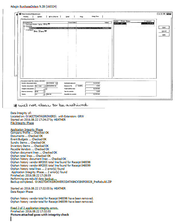

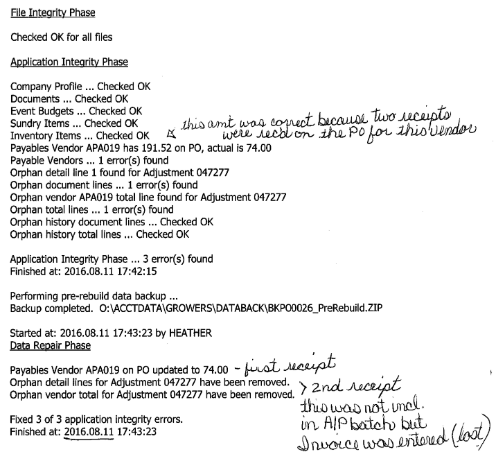

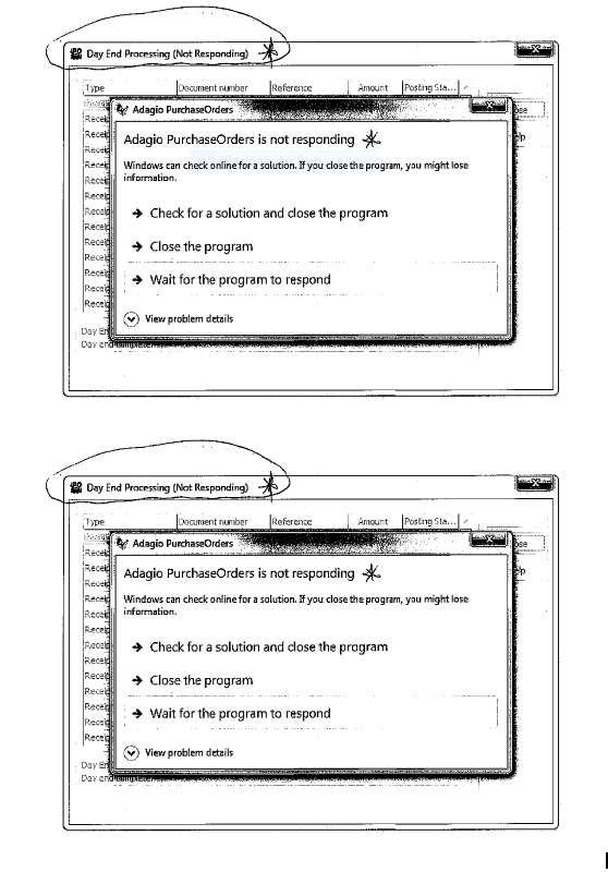

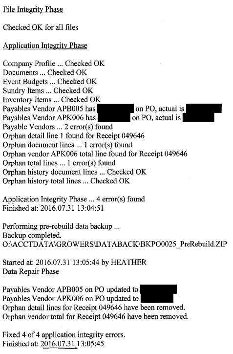

We are having issues with our Purchase Orders not responding all the time when posting a receipt to posting invoice etc. This happens with everyone on our system about 13 of us. I'm not sure when this happens if we are losing information because data integrity shows up with orphan files which are deleted in a rebuild and then data flow info is lost(example 5). Receipt will not archive with data flow missing(example 5). I'm attaching some of the screen prints and data integrity checks (4 examples).
