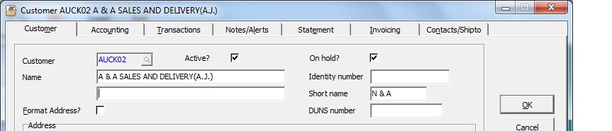

Upgraded to AR 9.0C (120224) and the client noticed that their customer statistic tab was missing. Please see attached.
Thought that given the new AR is out that once the upgrade was done it would rectify itself since I took a copy of the data and did not have that problem on my laptop.
The upgrade didn't help so I totally uninstalled the module and reinstalled it. Still not luck. I looked at the profile in both AR and OE.
Running current version AR 9.1A (130606). Can someone help with this?
ARCustomer Statistic Tab Missing.jpg (83 downloads)

Check their security group settings, it was moved there under the options section and turned off by default.
Warren
#37547 - 06/25/13 07:38 AM Re: Missing Customer Statistic Tab - AR [Re: Warren Karges]
Thanks a lot Warren that was the case. Never noticed that there or read it. All is fine now.
