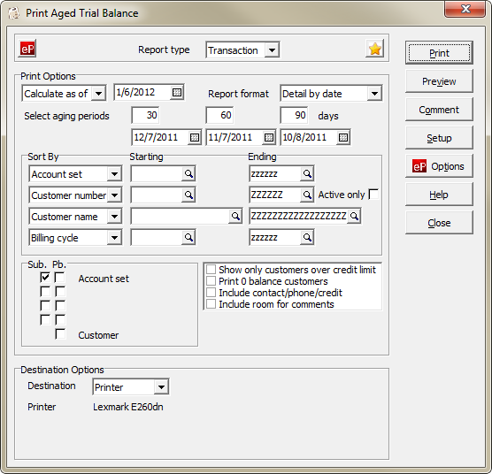

It's working for me. Warren, could you post a screen shot of the report options you've selected to generate the error? Is ePrint installed?
#30383 - 01/06/12 08:24 AM Re: Revised A/R V9.0C Aged Trial Balance [Re: Retired_Guy]
Warren Karges Offline
Registered: 08/04/11
Posts: 476
I didn't change anything from the defaulted report options, eprint is installed but not forced.
06-01-2012 11-20-58 AM.png (156 downloads)
Warren
